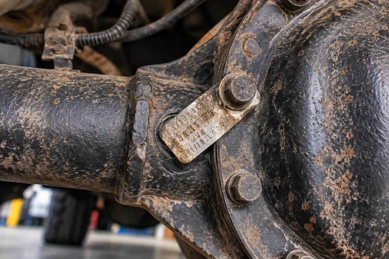

How to confirm it
  1. Decode GU5 for your model year.
  2. Read the axle tag — a 42/13 ring-and-pinion count is 3.23.
  3. Count driveshaft turns against two full rear-wheel revolutions. Close to 3.23 confirms it.
