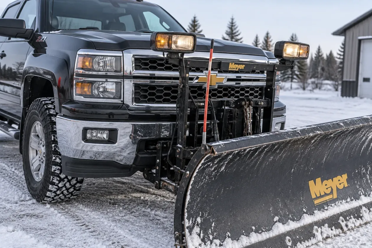

A truck with a plough mounted, or the front of a 4x4 showing the plough mount
VYU is the RPO code for GM’s Snow Plow Prep Package. If you are buying a truck to plow with, or buying one that has been plowed with, this is the code that tells you whether the factory built it for the job.
This is the best-documented package on this site: GM published a dedicated special-applications document for it, and it itemises the whole package.
