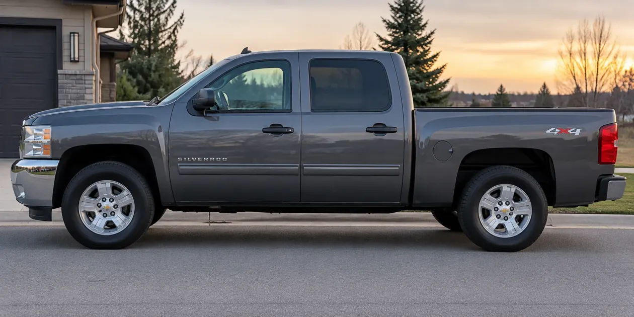

stock-height Silverado in profile
Most people find Z85 while looking for something else. They read the glove box label expecting Z71, find Z85 instead, and want to know what the difference is.
Z85 is GM’s standard handling and trailering suspension. It is the on-road setup. Z71 is the off-road one. A truck has one or the other, not both.
