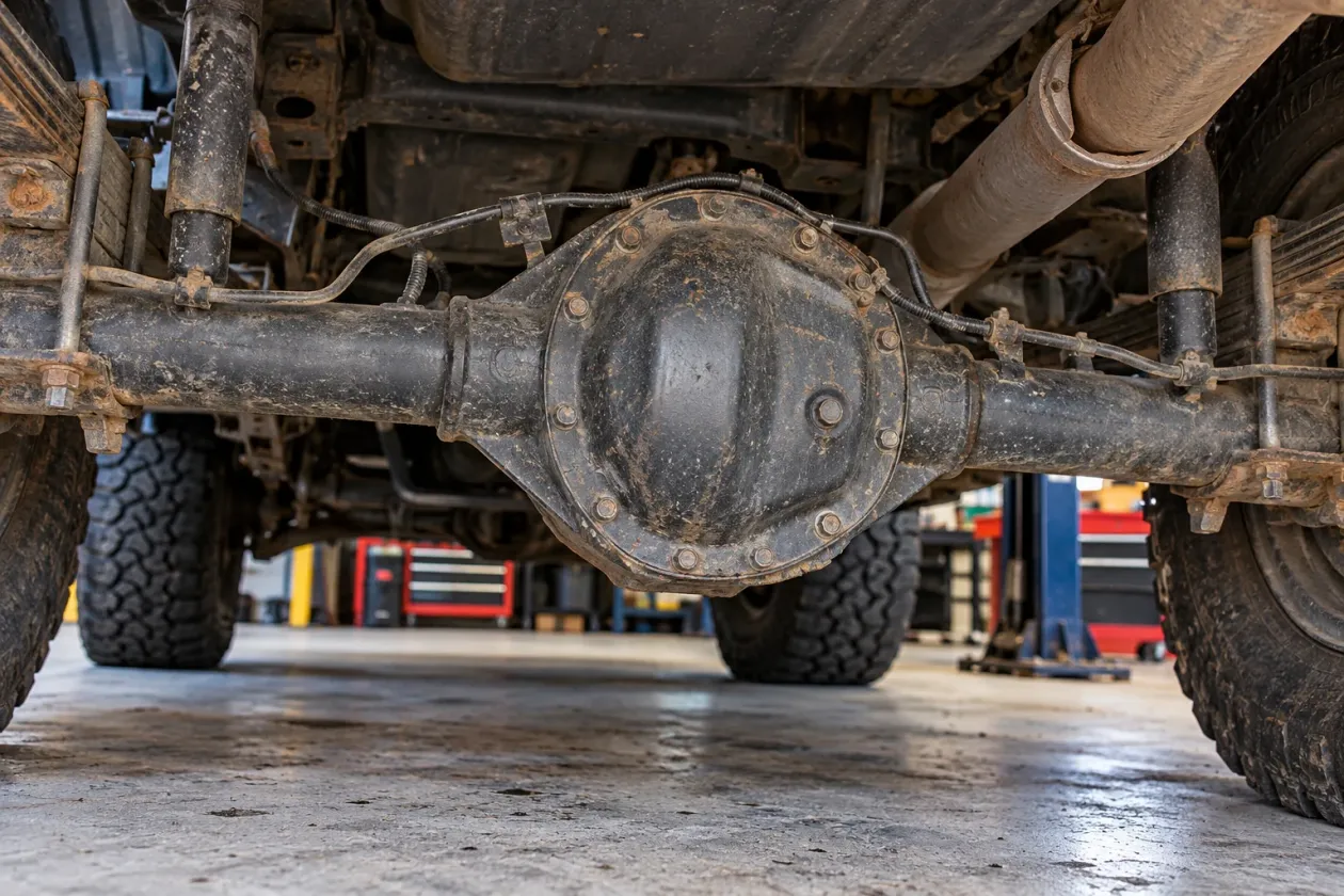

Rear differential housing and cover on a GM full-size truck axle
G80 is the RPO code for GM’s locking rear differential — and it is the most looked-up code on our decoder by a wide margin. It is also the code most likely to mislead you, because G80 has not meant the same piece of hardware for the last fifty years. On a 1973 C10 it is a Positraction clutch-pack. On a 2026 Silverado it is an automatic locker. Same three characters, different axle. Every GM axle ratio and differential code is side by side in our GM rear axle RPO code chart.
