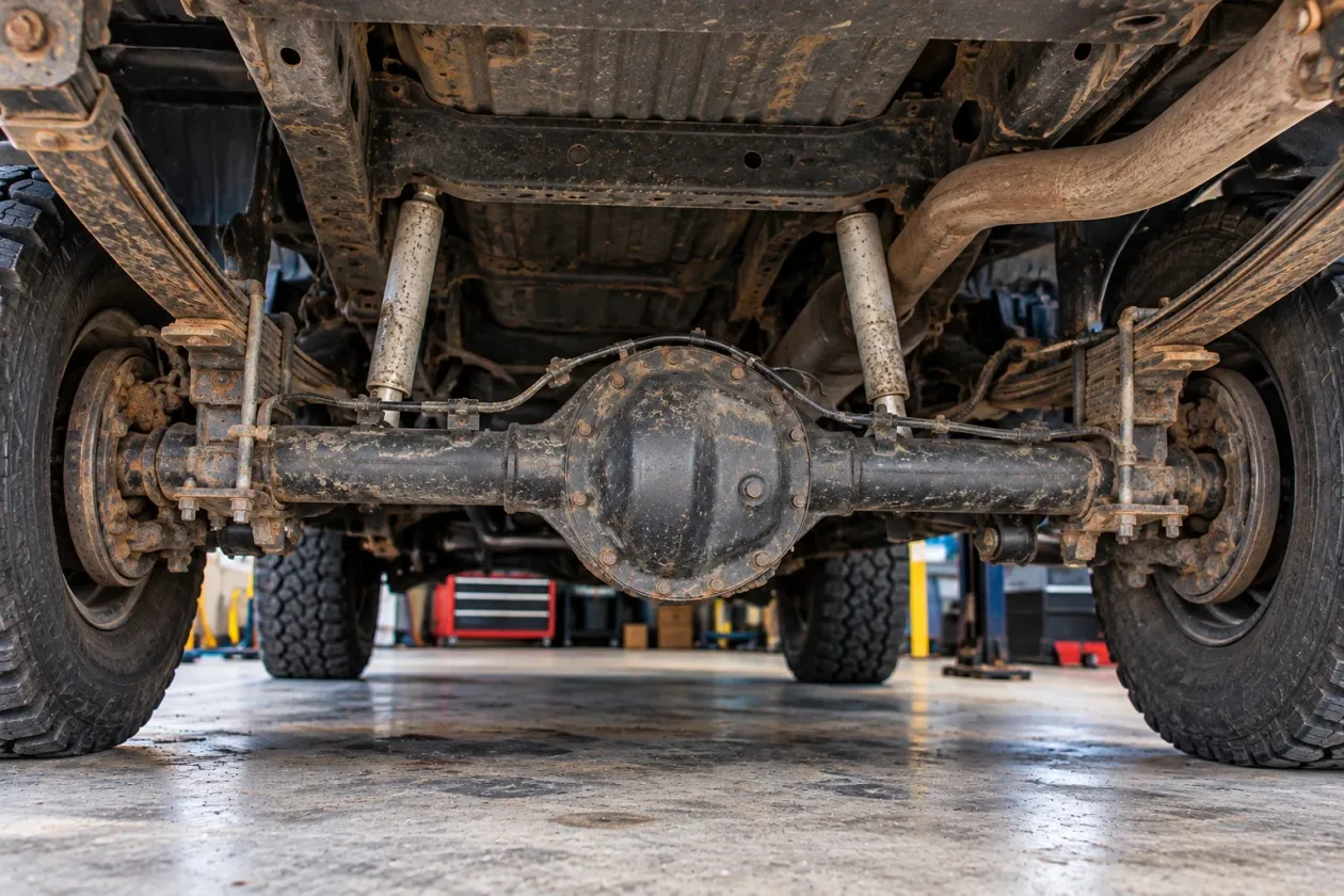

Rear axle assembly under a full-size Chevrolet truck
GU6 is the RPO code for a 3.42 rear axle ratio. On modern half-tons it is the single most common ratio GM builds, which makes it the code most owners find on their label and then misread as evidence of something special. It is not. It is the default. See where it sits against every other GM ratio in the GM rear axle RPO code chart.
