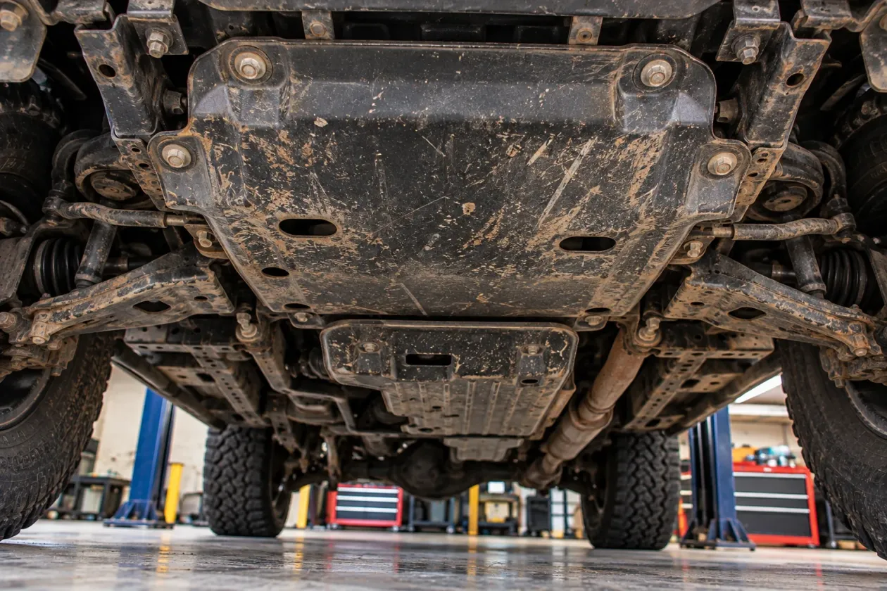

Factory skid plates bolted under the front of a four-wheel-drive Chevrolet truck
NZZ is the RPO code for GM’s off-road skid plate package — steel or aluminium shields under the front of the truck protecting the oil pan, the transfer case and the front differential from rocks and stumps.

What the plates actually cover
GM’s descriptions say “skid plates” and stop there, so the component list below is what you will physically find rather than something we can cite to a document. Check your own truck before assuming.
  • A front shield ahead of and under the oil pan and steering linkage
  • A transfer case plate on four-wheel-drive trucks
  • On some configurations, a front differential shield
  • On some years, a fuel tank shield
What NZZ does not include on any truck we have documents for is rocker protection or a rear differential cover. Those are aftermarket.

How to check yours
  1. Decode NZZ for your model year, and run the whole label so you see whether Z71 and NQH are there too.
  2. Get under the front of the truck. Factory plates bolt to threaded bosses in the frame and crossmember, and the bolt heads are usually still painted body colour or black. Aftermarket plates use clamps, U-bolts or drilled holes.
  3. Look for damage while you are there. A plate that has taken a hit can be bent into whatever it was protecting.
