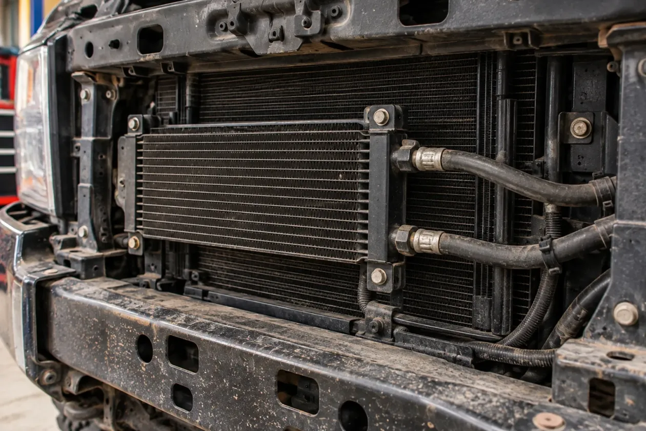

What Does KC4 Mean? The Engine Oil Cooler
Auxiliary oil cooler core mounted ahead of the radiator on a GM truck
KC4 is the RPO code for an engine oil cooler — a separate heat exchanger for engine oil, not for transmission fluid. That last part is where nearly all the confusion comes from, because the transmission cooler has its own code, KNP, and the two get used interchangeably in listings by people who have never looked at either.

How to tell if your truck has it
You can check this physically, which is more than you can say for most codes.
  1. Look between the grille and the radiator. An external engine oil cooler is a small finned core mounted ahead of the radiator or the condenser, fed by two hoses.
  2. Follow the hoses. On an engine oil cooler they run to a sandwich adapter at the oil filter, or to fittings in the block near it. On a transmission cooler they run to the radiator tank and then to the transmission.
  3. Decode KC4 for your model year to confirm it left the factory that way rather than being added by a previous owner.
