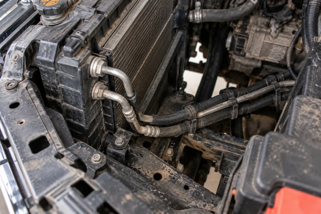

Transmission cooler lines running from the radiator to the transmission
KNP is the RPO code for an auxiliary external transmission oil cooler. It is the code that separates a truck built to tow from a truck that merely has a hitch on it — and on an automatic, transmission heat is what actually kills the drivetrain when you overload it.

How to check yours
  1. Decode KNP for your model year and read the whole label — KNP travels with Z82 and NHT often enough that the combination tells you more than the one code.
  2. Look ahead of the radiator for a second finned core with two metal lines running rearward and down to the transmission.
  3. Follow the lines. If they terminate at the radiator side tank and nowhere else, you have the in-radiator cooler only — standard equipment, not KNP.
