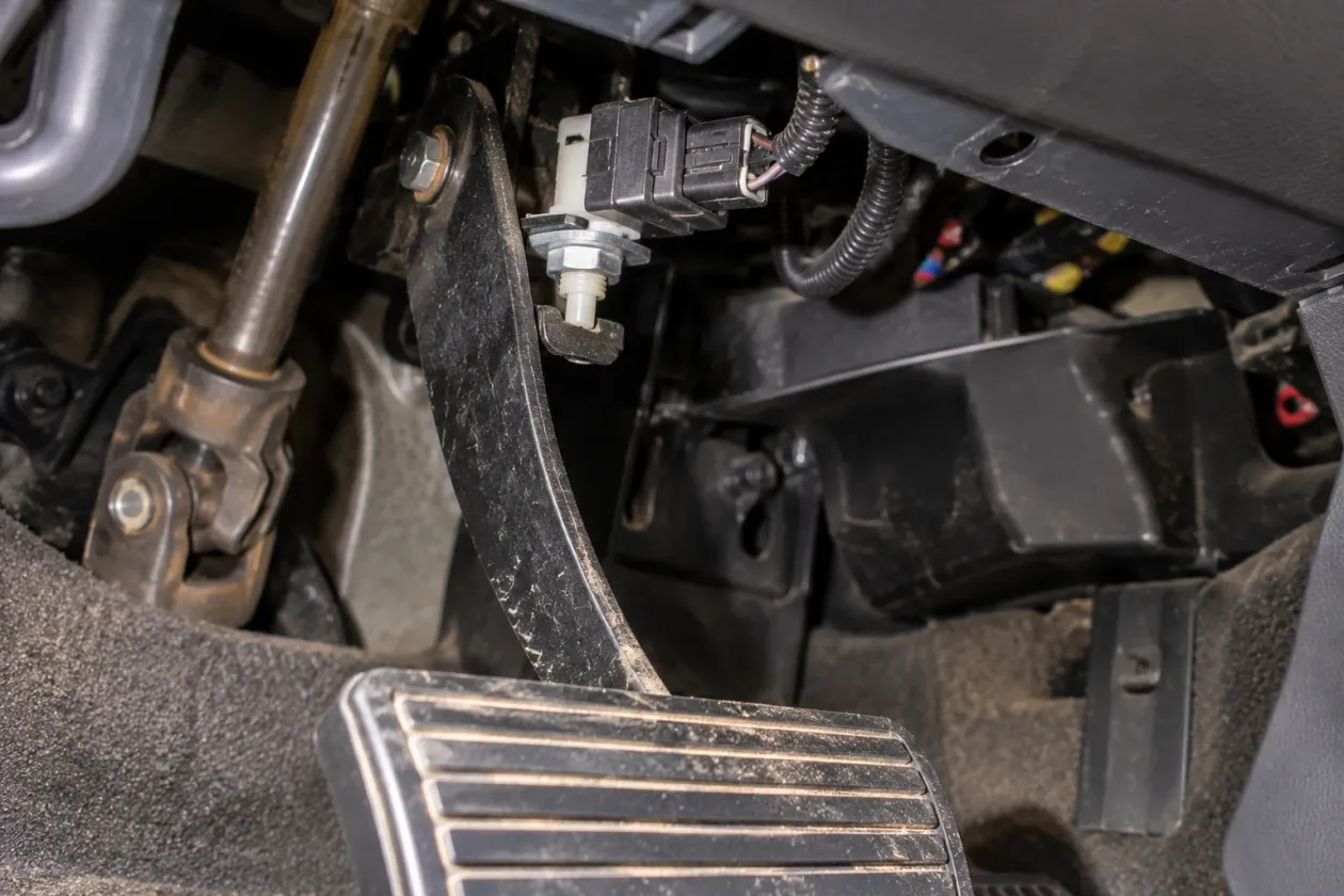

Brake light switch at the top of the brake pedal arm under a truck dash

  • A brake switch with the extra contact set that cancels cruise

If your cruise stopped working
On GMT800-era trucks the usual culprit is not the cruise system at all — it is the brake light switch, which carries the cancel circuit. Cruise that will not set, brake lights stuck on, and a shifter locked in park all trace back to the same cheap part. We covered it in the GMT800 brake light switch fix.

  3. If K34 is absent but the wheel has buttons, the wheel was changed. Check the clockspring and brake switch before buying a module.
