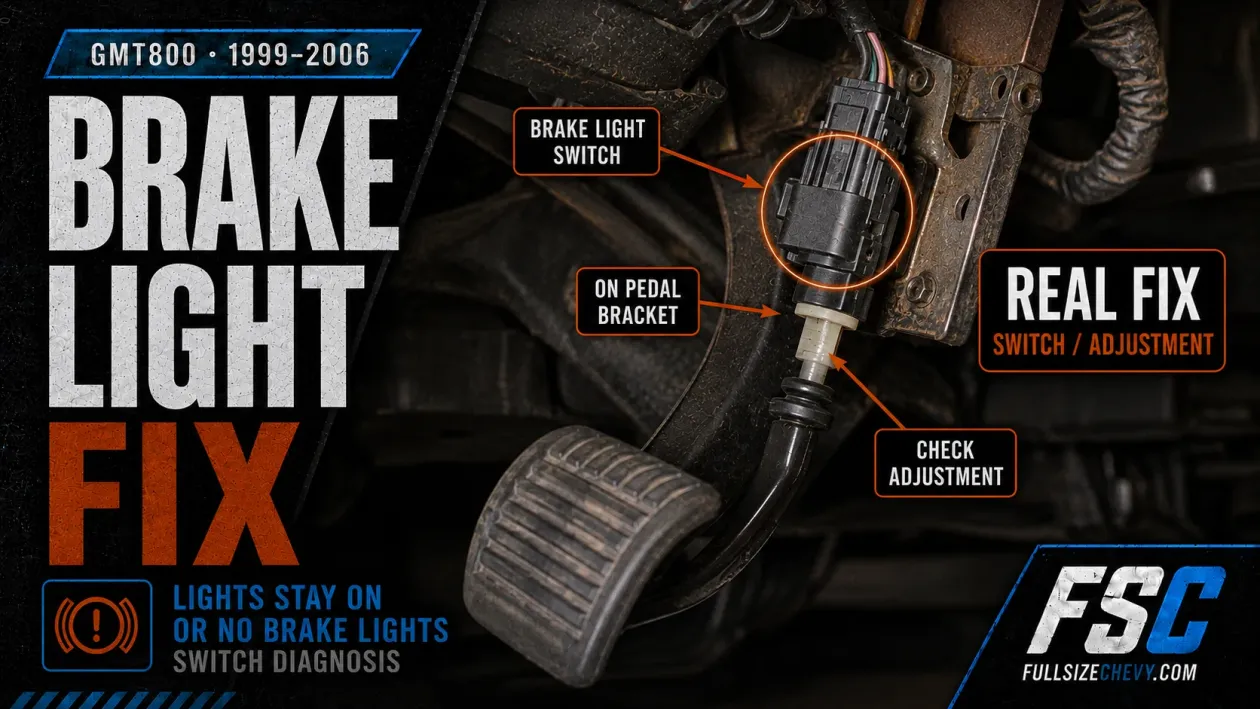

If your 1999–2006 GMT800 has brake lights that stay on, brake lights that don’t come on, cruise control that won’t set, or a shifter stuck in park, one cheap part ties all of that together: the brake light switch at the top of the pedal. It feeds the brake lamps, the cruise cutoff, and the shift interlock — so when it fails or falls out of adjustment, several things act up at once.

  1. Brake light switch failed or out of adjustment at the pedal — by far the most common.

  1. Match the symptoms. Multiple items acting up together (lights + cruise + shifter) strongly points at the brake switch.
  2. Check the switch at the pedal. A switch that’s stuck, misadjusted, or has a cracked plunger bracket will misbehave.
  3. Test the switch operation with a test light/meter — the circuit should make and break as the pedal moves.

  • Replace with a quality ACDelco/GM Genuine brake light switch and set the adjustment correctly at the pedal.
  • Check the plastic pedal bracket the switch clips into — it can crack and throw off adjustment.
