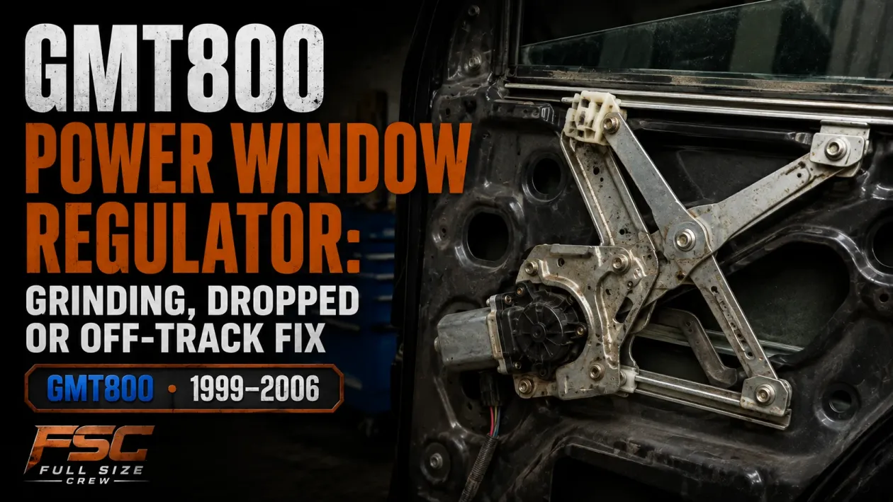

When a GMT800 window grinds, jumps, drops into the door, or goes up crooked, the culprit is usually the window regulator — not the motor. The plastic guide pieces on these regulators wear and let the glass come off its track. Knowing whether it’s the regulator or the motor saves you from buying the wrong part.
