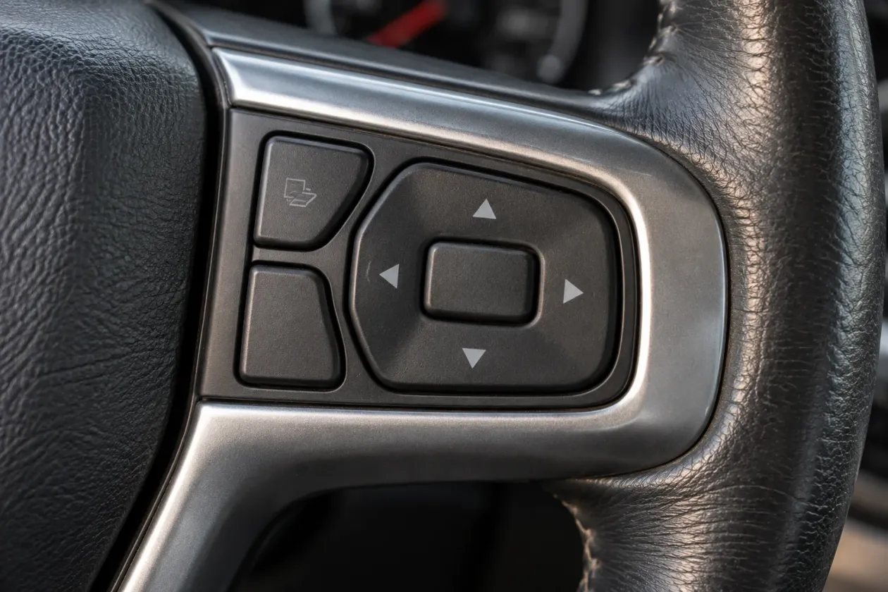

Control button pad on the spoke of a Chevrolet truck steering wheel
UK3 is the RPO code for steering wheel mounted controls — the buttons on the spokes. GM’s wording for it has shifted between “steering wheel audio controls” and the broader “steering wheel controls”, and our records hold both.

On a truck with UK3, the buttons do not talk to the radio directly. They sit on a resistive ladder or a data bus and the factory head unit knows how to read them. Fit an aftermarket radio and that conversation stops.
The fix is a steering wheel control interface — a small module wired between the wheel circuit and the new radio. It is inexpensive and it works well, but you have to know you need one before you buy the radio kit, because the interface is usually a separate item.
If your label has no UK3, there are no buttons to preserve and you can skip that module entirely.
