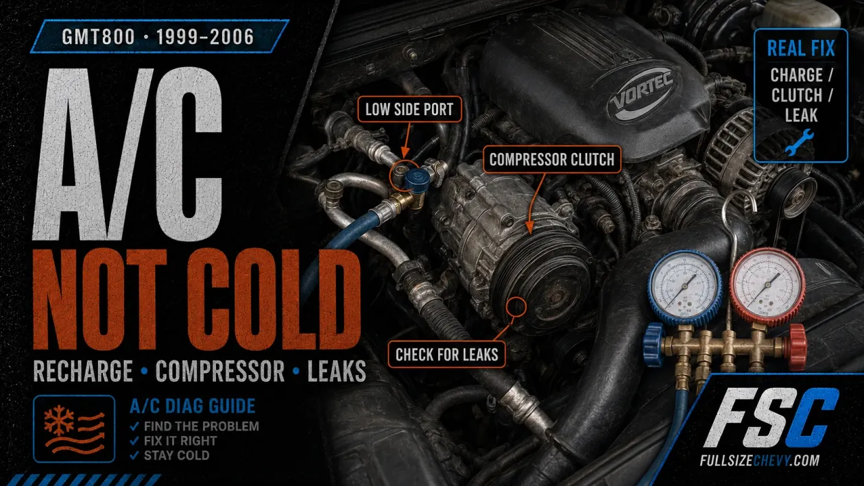

Diagnosis in the right order
  1. Watch the compressor clutch. No engagement = low charge/pressure lockout, clutch, or electrical.
  2. Gauge the system (both high and low side). Pressures tell you charge level and point toward compressor or restriction problems.
  3. Leak-check with UV dye or an electronic sniffer if it keeps losing charge — find and fix the leak, don’t just top it off.
  4. Rule out the air side. If refrigerant and pressures are good but it’s warm (or split hot/cold), check the blend-door actuator.
Recharge done right
A/C is a sealed system — if it’s low, it leaked. The correct process is to recover, repair the leak, pull a vacuum, and recharge to the specified amount (check the underhood A/C label for the R-134a charge weight). “Stop-leak in a can” can foul the system and complicate a proper repair later.
