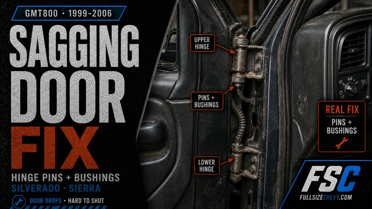

The steel hinge pins and their bushings wear over years of use. As the clearance grows, the door drops and rocks on the hinge. It’s mechanical wear, not something a “fix” spray solves.
The fix: pins & bushings vs. whole hinge
  • Hinge pin & bushing kit (the usual fix): drive out the worn pins, replace the pins and bushings, and the door lifts back into alignment. Cheap and effective for the vast majority of sagging doors.
  • Full hinge replacement: only needed if the hinge bores themselves are egg-shaped/worn beyond what new pins can take up — much less common.
How it goes
  1. Support the door’s weight (a floor jack with a block, or a helper).
  2. Drive out the old pins, remove the worn bushings.
  3. Install new bushings and pins per the kit.
  4. Check the door alignment and adjust the striker if needed so it latches without lifting.
