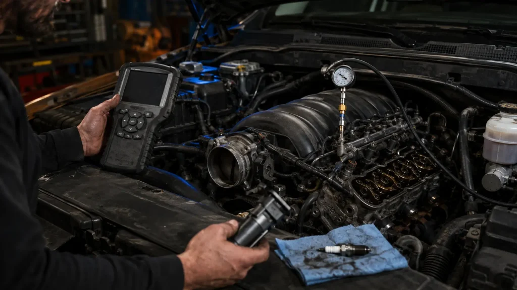

  • Spark plugs (most common): GM 5.3 engines are picky about plugs. OEM AC Delco iridium (part 41-162) only. Aftermarket plugs (Champion, NGK, Bosch) have caused widespread P0300 complaints. Gap spec: 0.040″ for most GMT900/K2XX 5.3L. Check plugs at 60K miles regardless of the 100K service interval on the cap.
  • Ignition coil packs: GMT900 and K2XX use individual coil-on-plug (COP) coils. When one fails partially, it misfires intermittently — if it drops enough misfires across all cylinders over a short period, you’ll see P0300 instead of a cylinder-specific P0301–P0308. Swap coils from the misfiring cylinder to a known-good cylinder and see if the misfire follows.
  • AFM lifter collapse (5.3 trucks): A collapsed AFM lifter causes a misfire on that specific cylinder. If four lifters collapse simultaneously (all AFM cylinders: 1, 4, 6, 7), P0300 appears rather than four separate P0301-P0307 codes. This is a serious mechanical failure — do not ignore P0300 on a high-mileage AFM truck without checking oil pressure and listening for a tick.
  • Fuel injector fault: A stuck-closed or dirty injector causes a lean misfire on that cylinder. Can appear as P0300 if multiple injectors are degraded (common on high-mileage trucks with long intervals between fuel filter service). Try a BG 44K or Seafoam fuel injector cleaner first.
  • Vacuum leak: A large vacuum leak leans out the entire intake manifold, causing misfires across all cylinders simultaneously. Listen for a hiss at idle. Spray carburetor cleaner around intake manifold gaskets, throttle body boot, and brake booster line while monitoring idle RPM.
  • Low fuel pressure: A failing in-tank fuel pump causes fuel pressure to drop under load, triggering misfires. Check fuel pressure at idle and under wide-open throttle — should maintain 55–62 PSI on returnless systems.
Diagnosis Order
  1. Pull all codes — check for cylinder-specific codes alongside P0300
  2. Check spark plug condition and brand — replace with AC Delco iridium if any doubt
  3. Swap coil packs from the most-misfiring cylinder to a known-good cylinder
  4. Check for vacuum leaks with carburetor cleaner or smoke machine
  5. Check fuel pressure at idle and WOT
  6. If high-mileage 5.3 with oil consumption history — inspect AFM lifters before anything else
