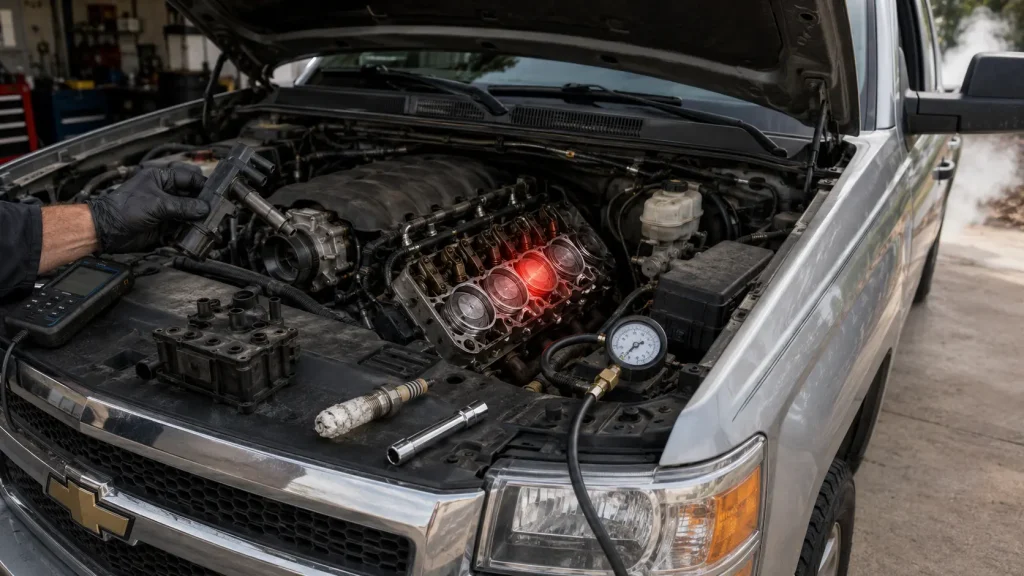

P0306 on a Chevy Silverado indicates a confirmed misfire in cylinder 6 — the third cylinder from the front on the passenger side of the engine. The diagnosis process is identical to all single-cylinder misfire codes, targeting the passenger-side bank.

Cylinder 6 Location
GM V8 cylinder numbering diagram with cylinder 6 highlighted, third from front on the passenger side bank
On all GM V8 engines: Passenger side front-to-rear = cylinders 2, 4, 6, 8. Cylinder 6 is the third cylinder from the front on the passenger side. This is an AFM deactivation cylinder on AFM-equipped 5.3L Silverados (2007–2021) — making lifter failure a specific risk at high mileage.
