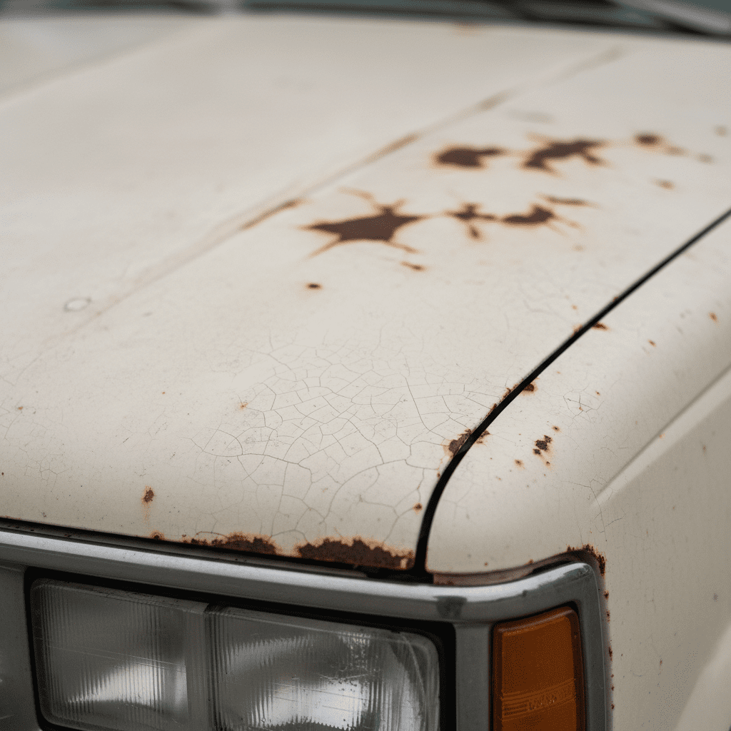

Old paint doesn’t have to mean giving up on your truck’s shine. Years of oxidation, swirls, and faded color aren’t a lost cause if you know the right products and process. This guide breaks down a proven summer detail that works on Squarebody to GMT900 trucks—covering wash, decon, correction, and protection with real pad and product combos that get results. Fire up a test spot, then hit forum.fullsizechevy.com to share your setup and lock in that gloss all season.
