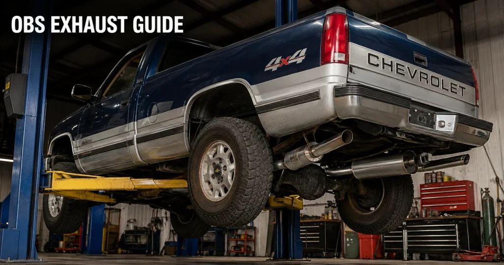

Top view of an OBS Chevy: muffler ahead of the rear axle, spare behind it, exhaust exiting out the passenger side past the rear wheel rather than out the back.
The muffler sits ahead of the rear axle and the spare hangs behind it. On these trucks the pipe exits out the side, past the rear wheel — the factory single behind the tire, most bolt-on cat-back kits just ahead of it.
