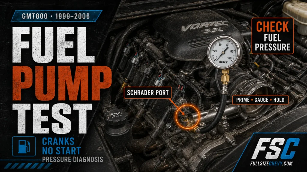

  1. Listen for the prime. Key ON (engine off), you should hear the pump run ~2 seconds. No hum points at pump, relay, fuse or wiring.
  2. Check the fuel-pump fuse and relay in the underhood box. Swap the relay with an identical one to test.
  3. Gauge the fuel pressure at the Schrader port on the fuel rail. Key ON, spec is 55–62 psi on the standard system (48–54 psi on flex-fuel). Verify the exact figure for your truck against GM service data.
  4. Watch the pressure hold. If it starts near spec then bleeds down quickly, you’ve got a dying pump, a leaking injector, or a bad regulator — not a no-fuel condition.
  5. Confirm spark and security last. If fuel pressure is good, check for spark and watch the security light during a no-start.
