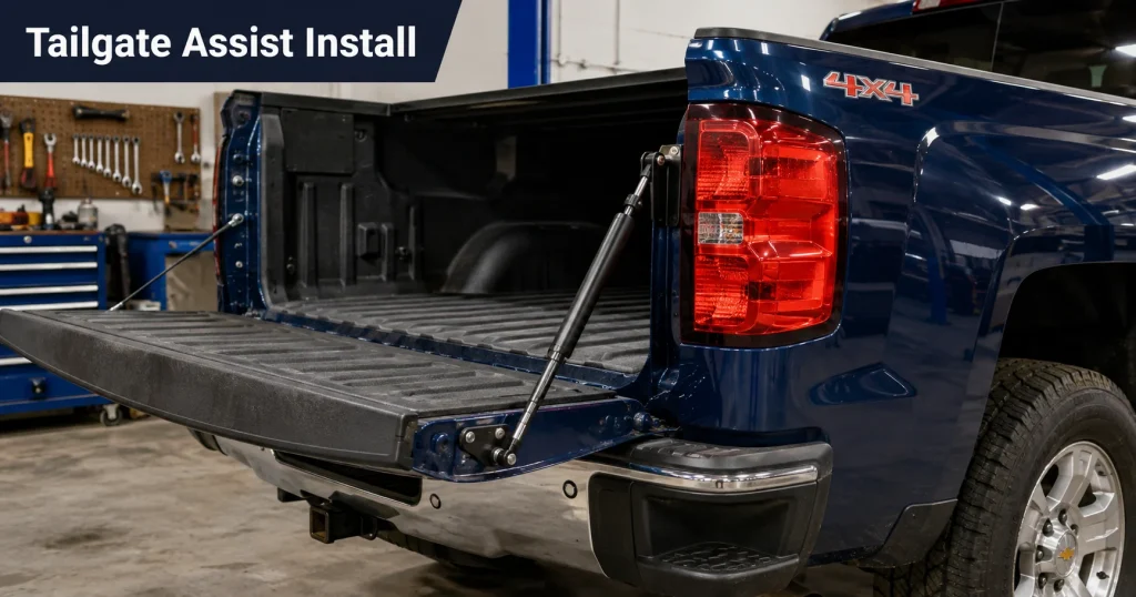

Short version: the DZ43102 is a gas-strut-style tailgate assist that mounts between the bed and the tailgate on the driver’s side. No drilling on most trucks. Real install time is 15–30 minutes with hand tools.

Install process
Diagram of DZ43102 bed bracket and tailgate pivot mounting points.
The three points that matter: bed-side bracket, gas strut, and the tailgate pivot on the driver’s side. Schematic — follow the printed Dee Zee sheet for exact bracket position and hardware.
  1. Open the tailgate to the flat, horizontal position and support it. Don’t let it hang on the cables while you work.
  2. Locate the driver-side tailgate pivot. The DZ43102 mounts on the driver’s side, tying the strut to the bed and the tailgate pivot area.
  3. Install the bed-side bracket per the included instructions, using the factory bolt locations. Most trucks do not require drilling.
  4. Attach the strut to the bed bracket and to the tailgate pivot point. Make sure the strut is oriented the way the instructions show — these dampers have a correct up/down and in/out orientation.
  5. Torque the hardware to the values on the Dee Zee instruction sheet. Snug and check; don’t gorilla it.
  6. Cycle the tailgate up and down several times. The drop should be smooth and controlled, and the gate should still latch normally.
Follow the printed Dee Zee instructions for the exact bracket position and hardware on your specific truck. Fitment brackets and bolt callouts can differ slightly between the GMT900 and K2XX beds.
