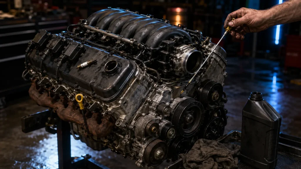

Chevy 5.3 V8 with oil-fouled spark plug — diagnosing 5.3 oil consumption
Short answer: If your 5.3 is disappearing oil between changes with no puddle on the driveway, the usual cause is Active Fuel Management (AFM). The AFM-equipped 5.3s (roughly 2007 and up) have a well-documented habit of drawing oil into the cylinders, fouling plugs and burning oil. The early non-AFM 5.3 (the 1999–2007 LM7 family) generally doesn’t share the problem. The fix depends on the cause — from a simple PCV/oil-management update or catch can up to an AFM delete or a ring job.
